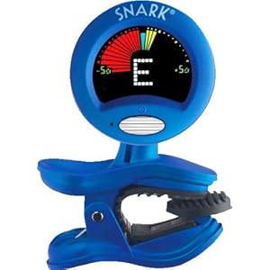

There are some economies of scale that come with consumer applications that drive some devices into the dirt, cost-wise. Almost any micro-electronics is a good example of that, and for what we're talking about here, accelerometers fall into that group. They're used in smartphones for orientation sensing, cameras for anti-shake compensation, collision sensing in collision air-bag deployment decisions, and they build gajillions of those things a year. So, they're cheap. Now you're seeing them in those clamp-on headstock tuners like the Snark...
You named me "Snark"? Really?
The guitar shops want $30 for them, but you can buy them online for less than $10 just about anywhere. Surprisingly sensitive and accurate, and somebody's still making money on them at that price. Tells you what the sensor costs.
So, what would it take to place a pile of those things on a holding fixture, add some A->D circuitry, and get the data into a computer to fiddle with? Seems like it should be fairly straightforward, other than about a million details.
