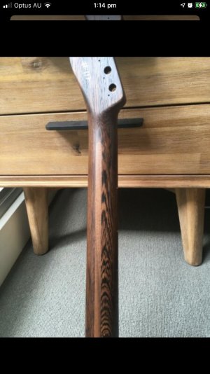

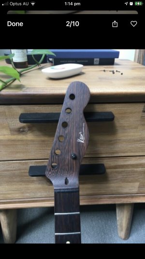

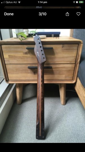

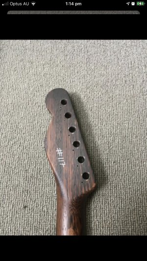

I have a 1/4 sawn wenge  neck and I can tell it’s stiffer than other wenge necks I’ve tried.  It could just be the piece of wood I have because it’s  from warmoth and it’s the only 1/4 sawn wenge I’ve ever got my mits on.

Looking at how rounded the grain is in some spots, I doubt it is quarter sawn. That grain should be pretty straight from end to end. But I can't guarantee either way. And, with wenge, it probably wouldn't matter, it's a very stable, rigid (and heavy) wood.

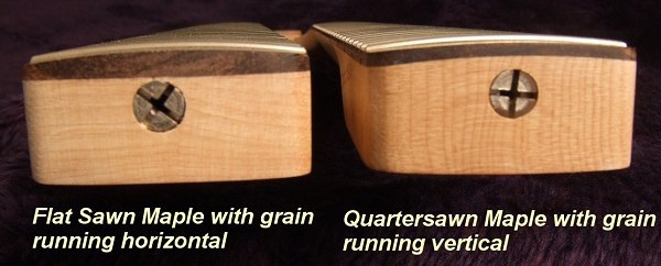

Yeah from the looks of the surface of the back of the neck, I'd initially say it was flat-sawn.  Here's another illustration that may help explain what to look for.
Flat-sawn, rift-sawn, and quarter-sawn, left to right.
Many quarter-sawn pieces will also have ray flecks, but not all.  Here is a quarter-sawn maple fretboard with pronounced ray flecks.
