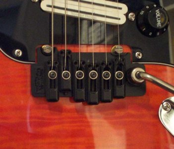

I built my first Warmoth strat about 6 months ago - Swamp Ash body, Warmoth Pro Bird's Eye maple neck/fret board, Wilkenson VS100 convertible bridge, LSR roller nut with Sperzel tuners.
The guitar set up pretty well for my first time.
I just pulled the neck off and yanked out the Fender SCN pups for a SD hotrails ( I still need to buy the cool rail and antique rail).
I set the guitar up again since it's been 6 months and my A string is flat. I have the saddle all the way towards the neck, but it is still flat at the 12th fret. The other strings are fine.
I have the bridge locked.
I set the truss rod, then the string height, then the intonation.
I have all the strings in tune.
I am using a Boss TU-12 tuner.
I did change from .009 DiAddarios to Ernie Ball .009 heavy bottoms, but I don't think that should make that big of a difference.

First thing I would do is go back to the original string gauge. That will either isolate or eliminate the strings being the problem. Next step...depends on result of first step.

Here's what I think,  You have that saddle so far forward, that you are droping the string a half step when checking intotanion at the 12th
you might be too focused on the tuner needle or leds, and not even seeing that it's no longer an "A"
Move the saddle back to near the others and try again, This is where a good old strobe tuner comes in real handy,

What you have is a physical impossibility.
Either you have a bad string (possible), or you got sharp and flat reversed.

I thought it was a impossibility. What exactly is a bad string? Is it one that won't hold tune?
I will move the saddle back with the others and start again.

They refuse to intonate, have bad and or ghost notes, have buzzes... I'm guessing its a winding issue.

The A saddle must belong set in between the E saddle and the D saddle, or the physical laws of the universe have been upended. Strap on your seatbelts in case gravity has been reversed too.

I re-strung the guitar today with all new strings. I decided to go back to .010 gauge. I used to use them on my SG for years, and I wanted to add another spring to tighten up the bar.
The guitar is fine now. I moved that saddle all the way back before I started, and it was almost perfect.
I guess it was something with the strings. Both sets were Ernie Ball BTW.
Whatever is was, it fixed now and I just got done playing for about 4 hours. I feel like I got a new guitar again!
