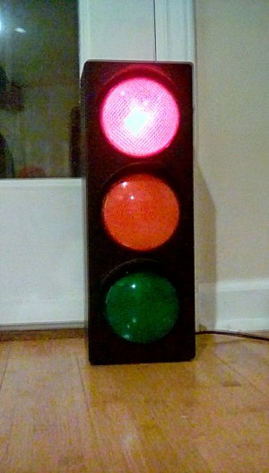

So I was joking on another forum about a stoplight, and found they make such a device for classrooms. Runs about $100. Yikes. (Also, I don't like their rules for my application) But, as it turns out, I have a plastic stoplight about 12" tall sitting in the closet, and a bunch of microcontrollers in a drawer. Just bought a bunch of LED (easier/cheaper to drive directly from microcontroller pins), and bought a little electret mic/preamp board off ebay. Total outlay for stuff I didnt already have sitting around, like $15.
I showed him the stoplight, told him the new rule. He appears very interested in the stoplight, so I'm hoping this works. Still waiting on the mic board, but I worked some on the controler code this weekend.  Basically it works like this:
<  85 db - Light is green
>  85 db - Light is solid yellow. Hearing Protection Required  (Takes about 30 seconds to clear, may go up to 5min or so)
> 105 db -Red light also comes on (yellow stays on). Too Darned Loud.  Takes about 2 seconds to clear once you drop below 105.
I'm still waiting on my sound board to arrive, but I'm hoping to get my LED's wired up, replace the 120v bulbs &  wiring, and drive it off serial commands for now. It kinda started as a joke, I'm optimistic that it'll help with compliance here, but like... everyone needs one of these in their rehearsal space. (Our limits are kinda strict cause he's so little.)

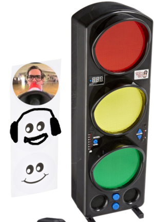

Finally got back to this one. Originally intended to drive the LEDs from the micros pins but found the Teensy 3.0 I used only so sinks a few milliamps. I used an Adafruit adjustable gain electret mic board, and an Adafruit  TCL59711  pwm led driver board, with three white 10mm LED's each light running about 15mA each.
Current rules are 70 and below for 10 min goes idle and blinks every few seconds. 70-85db is green. 85 - 92 db is yellow, downgrades in 1 second (so warning yellow can be seen but backs off if you do). 92db and up is red, and you have to stay below that for 5 minutes before it downgrades. (So he doesn't try to take em off every time the light changes.)
Will have to do a rough calibration, but I think the math is probably close enough for rock n roll.

Yeah, that didn't take but 10 seconds to turn into "make the red light come on" game.
