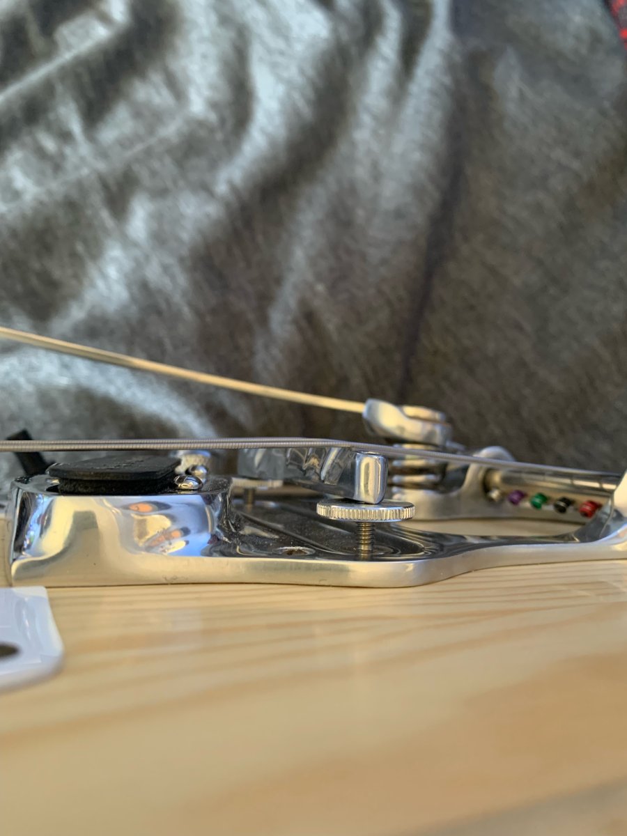

Not sure you need to recess a TOM. Look at a Bigsby B16 setup
Sure, that's clearly a TOM-style bridge that isn't recessed, but you need an angled neck pocket or a shim to make that work. Unless you're setting up to play sliiiiiide. ;)
A recessed TOM should work fine with a B5/50/500, without a shim. I'll caveat that the TOM is not my favorite bridge for Bigsby, but without knowing your other considerations (pickups, etc.), it may be the best tool for what you want to do.
But the B16 does require a shim or angled neck pocket. They sit very proud.
Pics courtesy of TDPRI
img_0724-jpeg.1108400
img_0727-jpeg.1108402
That's a pretty tele bridge plate!
I like what they did to compensate the bridge pickup height for the required neck angle
