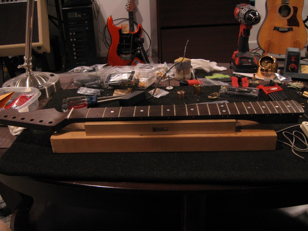

This pix is just where the neck needs to BE:
It's the sacred fretwork 2X4 on some rubber sheeting to hold steady, more rubber between board & neck, and RIGHT up against the edge of the desk so I can get AT the frets all the way from vertical to horizontal.
![Jag1006.jpg](/proxy.php?image=http%3A%2F%2Fi100.photobucket.com%2Falbums%2Fm1%2Fstubhead%2FMandolins%2520and%2520Plus%25202010%2FJag1006.jpg&hash=033201557afa07be2645dc2e19549369)
