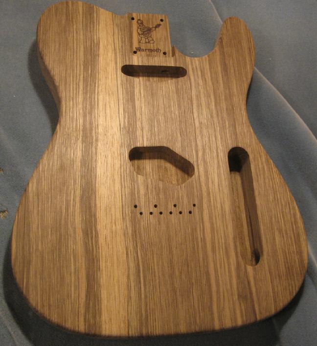

I am doing a Black Korina Tele. The plan is to have filler, die and tru-oil. Possibly nitro on top of the tru oil if I don't like it enough, but that question comes later.

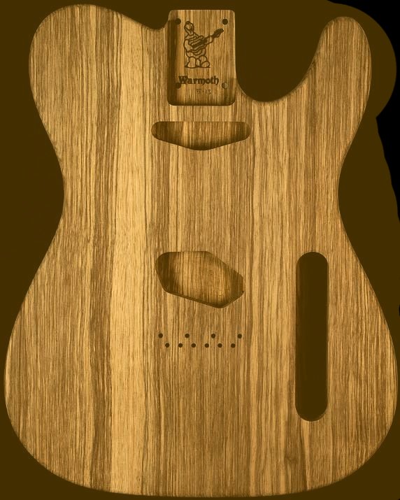

I actually want to drive the guitar into an orangeish direction, in fact I bought orange die. I photoshopped a orange hue on top of the unfinished state photo and I like it. Plus I will of course do whatever I want to do in the pickup or electronics cavity first to make sure I get what I want. "Orangeish" doesn't mean life vest orange.
I failed art what does green + orange make? If you have orange dye, test it on a small place on the back and have a stack of sandpaper ready, it may well turn out hideous.

I am testing all the stuff I'm going to put on before committing, that's how I noticed the filler is unsuitble. I will try the whole stack of what I'm trying to do in the electronics and pickup cavities first, but of course that is very limited space.

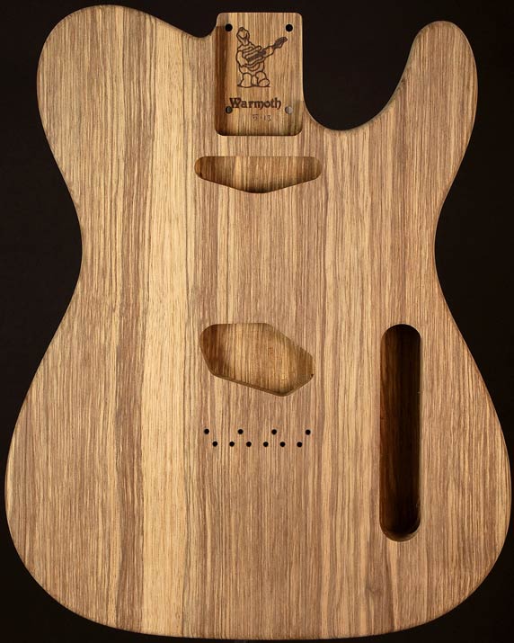

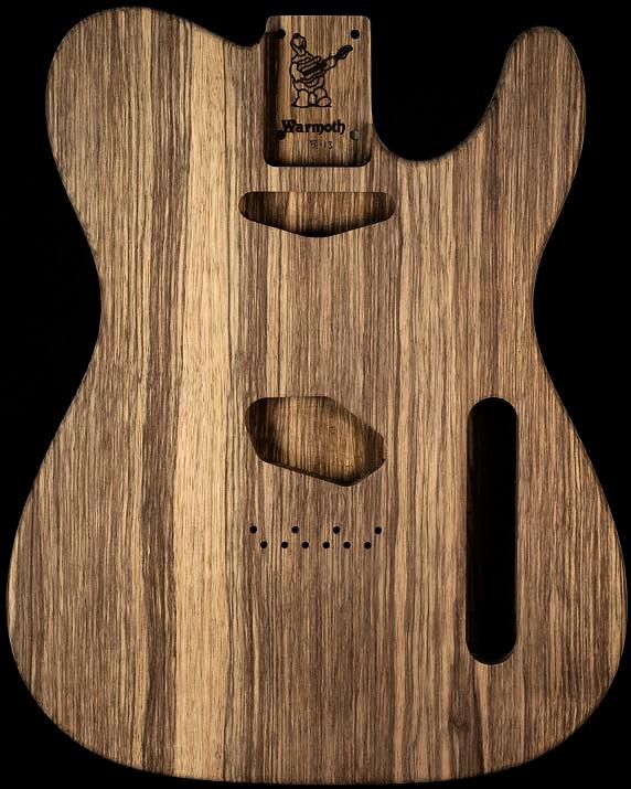

Unfortunately a family member just nuked my camera, but here are the last ones I have:
Here is the photoshop mock:
Original:
Grain enhance:
Orange stain:
Hmm, looking at the photos I see that my photo (first) is noticeably more greenish than Warmoths (the photoshop mocks).
