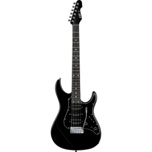

My favorite guitarist is the young Haruka Noma aka Hal-Ca from the prog-metal trio Asterism out of Japan. She has her own ESP Snapper custom with published specs: https://espguitars.co.jp/artists/34012/ . I looked into getting one of these made and imported by ESP, but it would be upwards of 9K all said and done to get it to me. So I have decided to recreate it with Warmoth parts.
SNAPPER_HAL-CA_custom.pngIt is the All Black one on the right that i'm interested to recreate. Here are the specs:
BODY Alder (Thickness 45mm)
NECK Hard Maple
GRIP SHAPE Slim U
FINGERBOARD Richlite®
RADIUS 305R
SCALE 648mm
NUT Carbon(42mm)
INLAY (Top)MOP Dot, (Side)Luminlay SGM-23
FRET JESCAR FW57110, 24frets
CONSTRUCTION Bolt-on (T-5 Ultimate Access/Brass)
TUNER GOTOH SG360-07 MG-T
BRIDGE ESP FLICKER-III
PICKUPS (Neck)Seymour Duncan SH-2n, (Middle)Seymour Duncan STK-S6, (Bridge)Seymour Duncan TB-15
PARTS COLOR Chrome
CONTROLS Master Volume, Master Tone, 5-WAY Lever PU Selector, Mix Variation Switch
So here are my current questions. What is the most economical way to get a jet black fretboard? I know Richlite is an off-menu option but it is pretty much as costly as black Ebony. Is there any other way?
Is the only way to really accommodate 24 frets to have a soloist body? I basically have surrendered to just having 22 frets.
I can't seem to get Luminlay side dots as an option with the neck im trying to make... what gives?
Folks agree that a Warmoth Gloss finish would match that the closest?
How should I get the neck finished? Say if I go with Richlite? do they mask off the fretboard when finishing the back of the neck? I know gettting the headstock painted is an off-menu option.
I'm gonna be a first time builder so any tips etc. you have for recreating a guitar I'd love to hear.

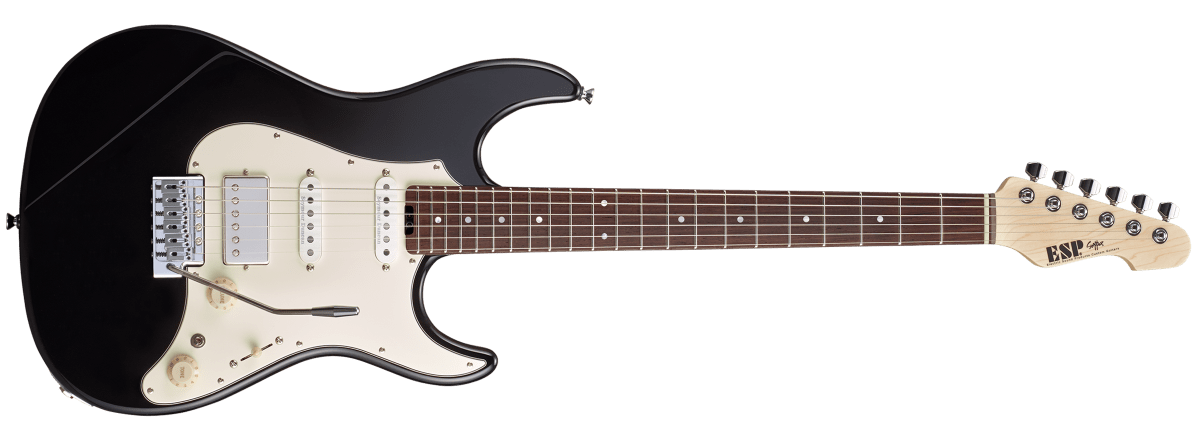

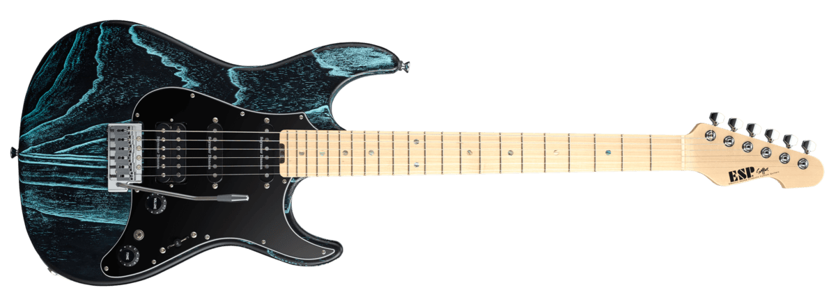

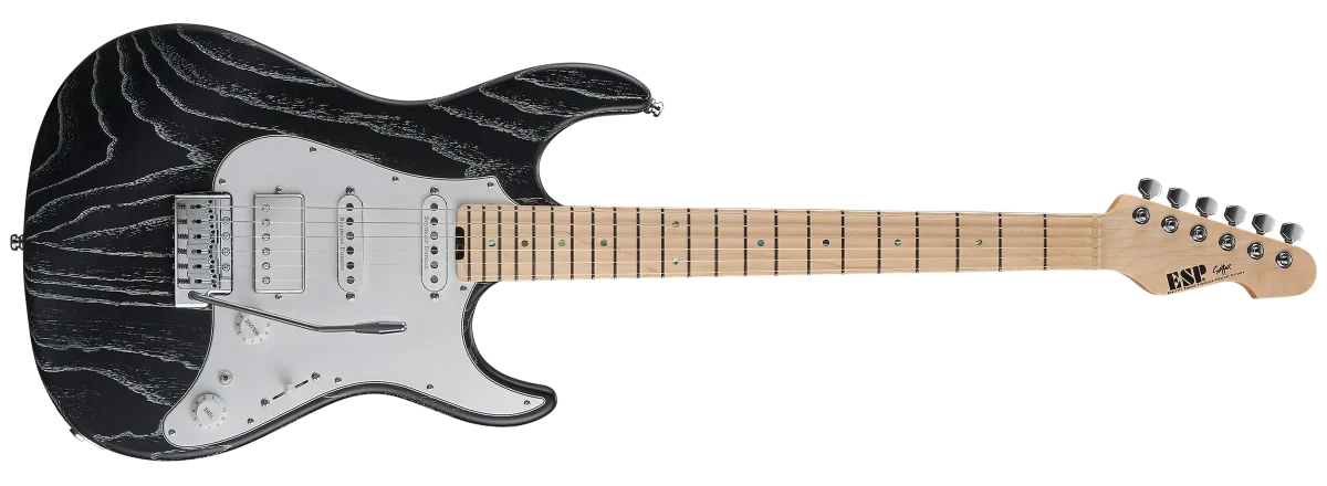

If you really want a Japanese ESP guitar, it may be possible to buy direct from Japan, although it won't be particularly cheap. Did you see the standard "Snapper" models on the ESP website?
I actually asked Trogly by email to help me import one. He asked his Dealer in Japan and they said they would not make one. I have no idea why. It also would be like 8K without even getting it overhere... so Partscaster it is.

Yeah thats very close to the look im going for... blaker than black. Thats gonna be a sweet looking guitar.
