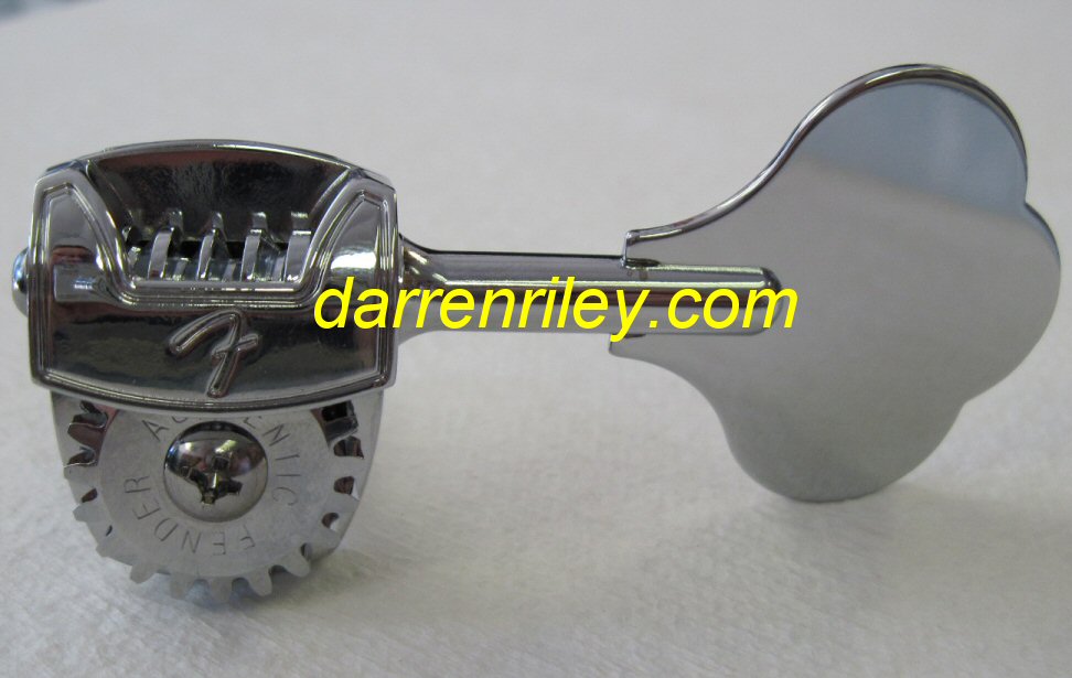

Ask away, buddy.  If you decide to go the more traditional neck route, do yourself a favor and get Fender F-stamp half-open tuners.  Can be hard to come by, but worth every penny.  They are the only tuners I use anymore.
