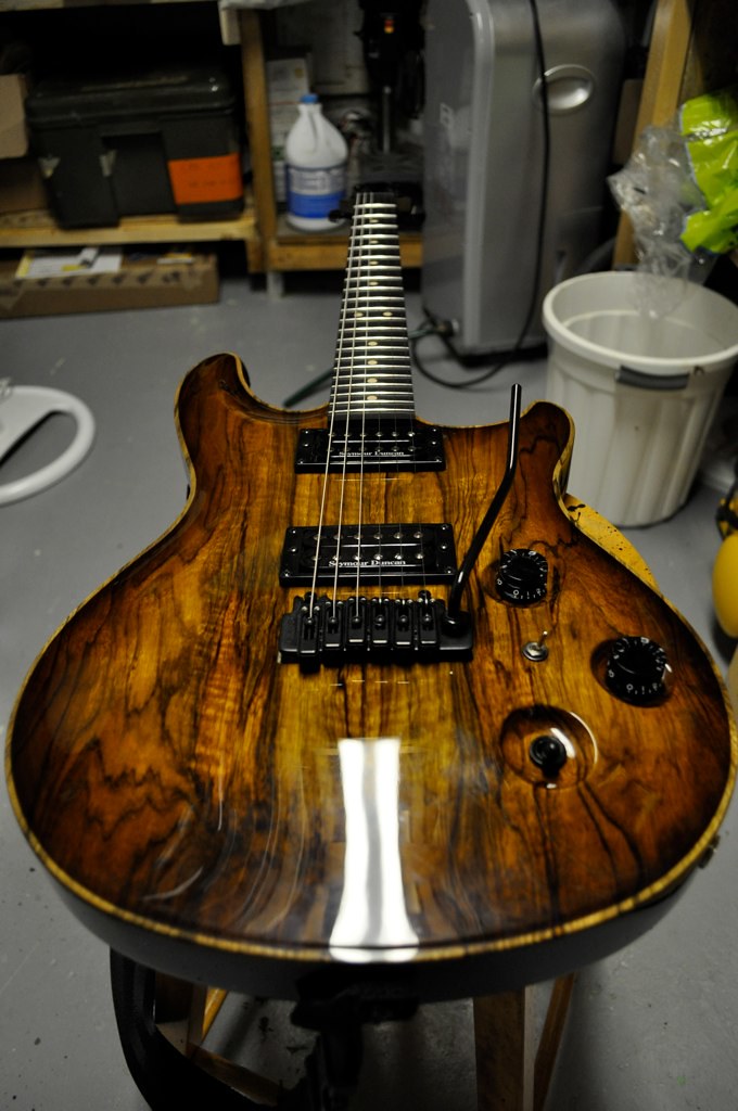

By bridge sits pretty low so I do gain some room with the recessed area.
I'm pulling back the trem bar as far as I can in the picture.
I gain a bit of extra room with mine. The main thing is that with a standard vibrato unit you hit the body pretty hard when you pull up, but with the route pulling up feels a bit... softer I guess?
