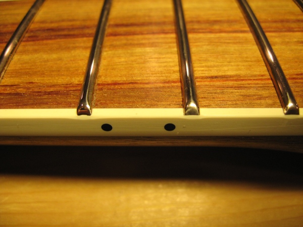

Basically, they install the frets, bevel the ends and call it a love story. There's no effort to level or dress them. A new neck will typically look something like this...
Leveling (and subsequent recrowning) isn't something you can really see as much as measure and feel, but once that's done, some prefer the ends to dressed and polished...
All that allows for a lower action and more comfortable playing.

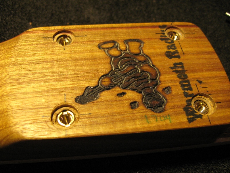

Then, some like to have threaded inserts installed to make neck installation/removal easier with machine screws instead of wood screws and provide for a tighter coupling between the neck and body. It provides for slightly more sustain and articulation...
