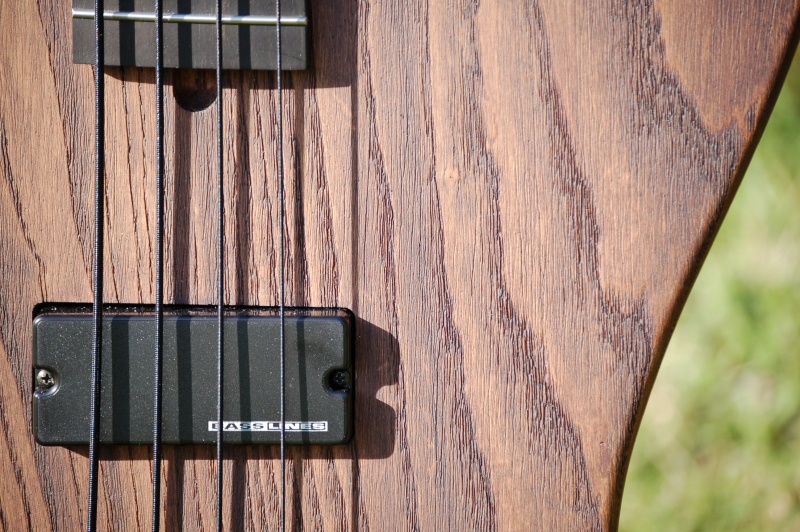

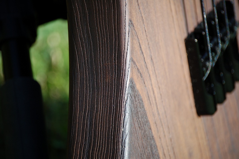

This is swamp ash when it's not filled - I actually used a steel brush to make the grain stand out as much as I could, so here it's very much intentional. If you simply omit the grain fill you will probably wind up with a guitar that just screams 'amateur finish'...
