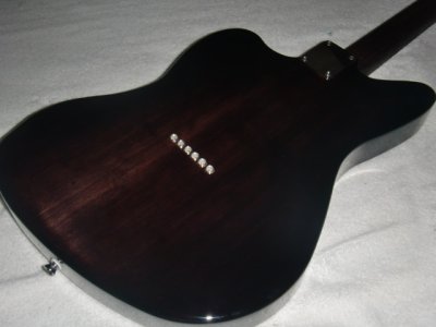

The alder back on the guitar pictured really needed grain filler. As a rookie - I didn't use it. But, guy shooting clear had to do many, many coats to get it to fill in.
So, I suggest going by the piece of wood itself. If you start finishing sanding and you still have deeper spots, you may need grain filler on the particular piece of alder.
