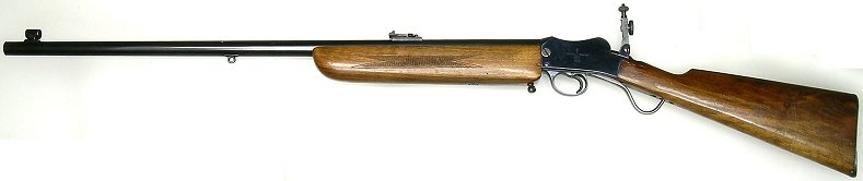

I still think of a rifle I did.  It was a BSA .22 Martini, target rifle.  Made in Birmingham, England, 1957.  It got probably 12 applications of linseed oil, over a six month period.  Another month to dry the last application.  Then I buffed it out using a new cloth wheel, no compound.  My GAW-D (the Rush way).  Amazing results on English Walnut... light in color, but nice figure.  Just amazing.

I bought that rifle for $150, and sold it for $575 - to get a Kimber "All American Match" .22 target rifle.  The Kimber is the better shooter, but the BSA won me more beer money, and hands down was king of the "cool" factor.
It was quite similar to this, but with the thinner forearm
and had pretty wood.
