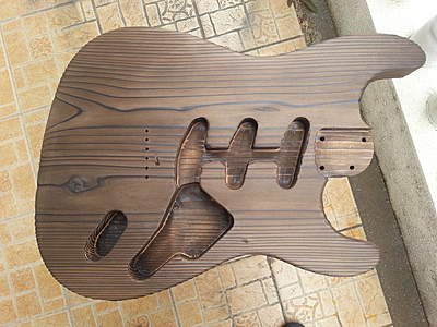

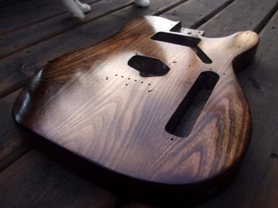

I'm on the fence with the wipe on poly or TruOil. The burned or charred finish is exactly that. Hit it with a torch. There's a lot of examples out there that leave a lot to be desired. There are some out there that look absolutely amazing though. I can't find the images that inspired me but I'll keep looking. Here's some others. Neither one is finished. I'll snap a pic of mine too.

Wow.  I like fire.  Fire is good.  Fire is fun.  Torch huh?  I'm gonna hunt around for some more infoz on this.  From what I have been reading, grain filling, how ever it's done is totally critical with Swamp Ash.

here is my burn...it was pine but the swamp ash should work well too.
http://unofficialwarmoth.com/index.php?topic=23951.msg349341#msg349341

That burn is a very interesting effect.  And yes, the neck is a beast.  Tiger looking beast I'd say.  Gonna get Tonar to do the Mary Kaye White probably with a light tan tint in the nitro finish, so it matches the neck a bit better.
