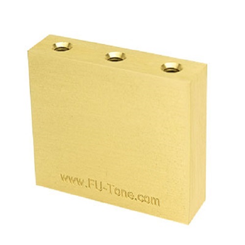

You would probably be better with the 36mm Gotoh block, the 40mm may be a little long in the body. Alternatively if you want to upgrade to a brass block in 37mm here is a link.
