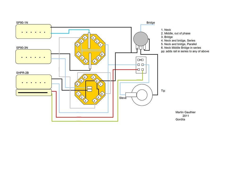

6 way rotary chosing Neck, Middle, Bridge p90, Neck + Bridge p90 in series, neck + bridge p90 in parallel, Neck + middle + bridge p90 in series; and a push pull volume pot that adds the rail to any of the combinations above for a little added punch.

The switching is interesting, any chances of posting up a schematic on how you worked out the rotary switching?  :icon_scratch:

Sorry - I've been AFK for quite some time.
Remember that because of the series wiring options, your P90's leads must be sheilded (I used heatshrink).
I you want me to add a tone, I could probably do that easily enough.
The middle-oop-with-rail option on the mid pup is not impressive, I think because the pups are very mismatched.
There may be some minor issues with the diagram - I'm working from memory - I'm pretty sure I'm missing a connection between the ground on my volume pot and my sleeve...
If it aint clear, I can talk you through it - the two octogons are the wafers on the 4P6T.
