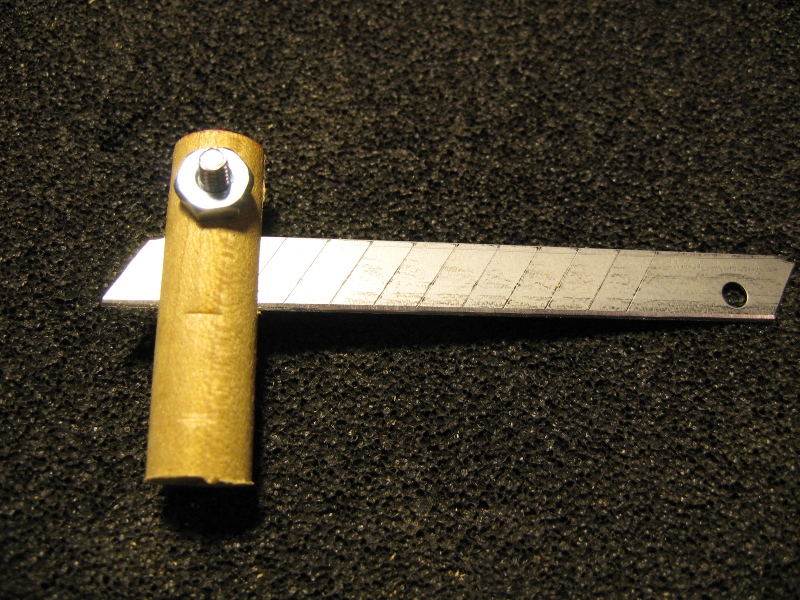

Scraping isn't as tough as you might imagine. You have to be a bit careful, but you can help yourself a little bit. When I did the L5S in my sig, I made this little widget...

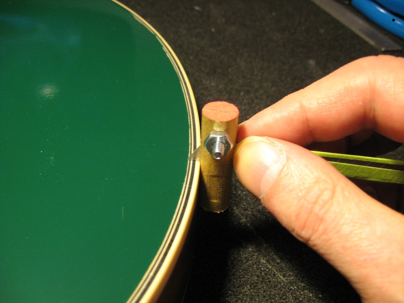

...which let me set a depth of cut so it would harder to slip and slice too far into the surface or something.
This is a setup shot; that's not how you'd hold the thing or the direction of cut it appears to be. I just wanted to show how the thing would work in practice. You can see where there's some scraped binding and some still left with paint overhang...
Doing it that way, I pulled it off successfully on my first binding job. Folks like Tonar and those at the Martin factory you visited probably do it freehand with a single-edge razor blade while gossiping with their neighbors. One of those "practice makes perfect" things where people learn to do complex things second nature.
I like you contraption Cagey.  Seems logical but I could see me screwing something up.  You are correct about Martin. Single blade free hand.  She made it look so easy.  They barely looked.  All by feel.
