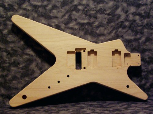

DocNrock said:
DangerousR6 said:
Hey Doc, you could get this one. It's alder unfinished, couple cans of krylon and you're good to go......But alas it's been cut with the non-recessed floyd...oh well...
http://cgi.ebay.com/NEW-XStar-Guitar-Body-HxH-Unfinished-Alder_W0QQitemZ350087691620QQcmdZViewItem?hash=item350087691620&_trkparms=72%3A1074%7C39%3A1%7C66%3A2%7C65%3A12%7C240%3A1318&_trksid=p3286.c0.m14&timeout=1218491961116
Naaaahhh, I'm a Warmoth snob.  :icon_thumright:
