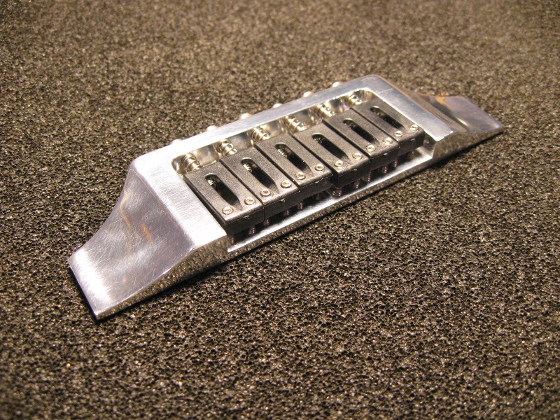

Another member (Scartozi, who hasn't been around for a while) had an idea to create an acoustic/electric style hybrid that worked out quite well. I think Updown and myself were the only ones to use them, though. Anyway, he based it on the shape of a typical wood acoustic bridge and had Doug machine it out of metal. Then, we installed standard saddles so as to get the intonation function and the ability to match up string radius to neck radius. I had two made - this is one of them [thread] ...

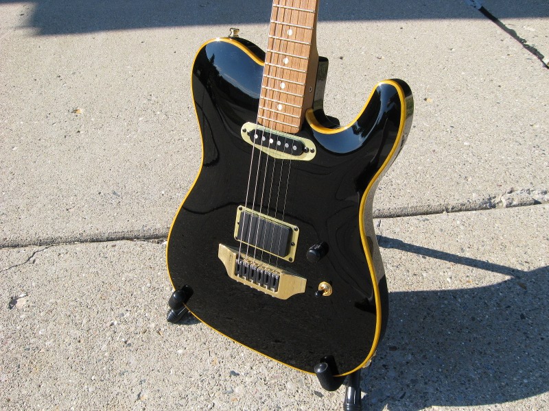

I also had a brass one made, which I put on a different Tele [thread]...
That brass unit is bright, Bright, BRIGHT! That's is one raucous guitar.
Yeah. But, his has a regular TOM that's mounted on a wood acoustic-style base. Not sure that's a good idea, either, but it's better than making the bridge itself out of wood.
