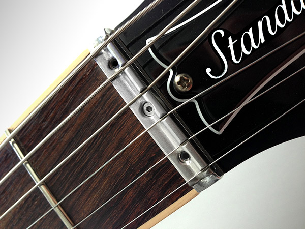

Here's a neck shot of the newer Gibson at the nut...
That nut is a great idea.  Too bad it is close to 1 3/4 long.  It really feels different.  I do not like it all and do not think getting "used to it" is an option.  If you have not noticed the new Traditional line went back to a 1 11/16 Corian nut..
