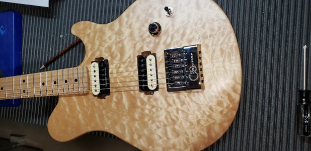

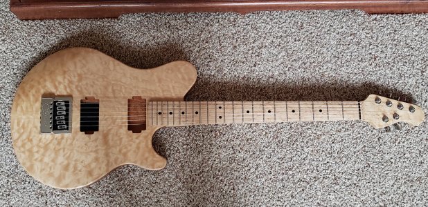

I am working on an EVH Wolfgang, Music man style.  The body is from USACG, quilt maple on mahogany.  The neck is Warmoth, birdseye all around.
I cut the headstock using a MM template.
Bridge is Evertune.  Finish is satin poly.  Pickups TBD.

Damn, that's cool looking. I like the headstock with that body. All maple on top looks good.
The owner sent it to EverTune for install.  A good deal of material was removed to install it.  I was not comfortable doing it.  I believe it is set for specific string tension and does stay in tune very well.  I will take the cover off and post some photos
Sweet, great job on the headstock. I still got a Warmoth VW I need to get a neck and do the 4+2 headstock. What did you start out with headstock shape wise?

Been a while waiting for the customer to decide on pickups
I also worked out the tuning on the bridge
  This thing is amazing.  It really holds tune well looks killer.  I hope to have it completely wired soon
