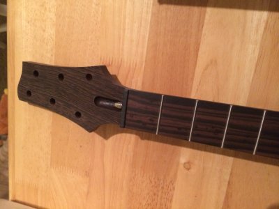

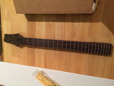

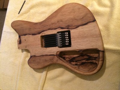

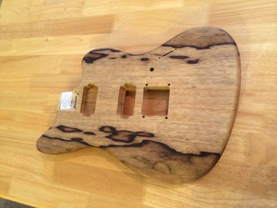

Sorry, I've posted these pics in 3 other posts but I just got the body and neck yesterday.  Hope to get started this weekend.
My goal for this was to make a bare bones rock machine.
Specs:
Black Korina Jazzmaster body Satin finish
Wenge neck Macassar Ebony fingerboard
Evertune bridge
Bare Knuckle Blackhawk humbuckers
volume and 3 way switch

dry fit the bridge....
see thread...

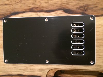

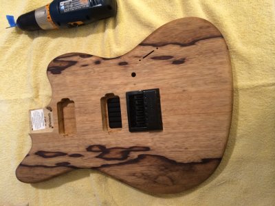

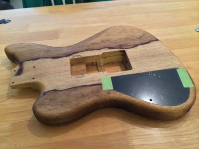

Took a bit of work to get the bridge on, had to increase the screw holes for the bridge faceplate to fit.  Also the screws on the back don't match up with the Evertune backplate.

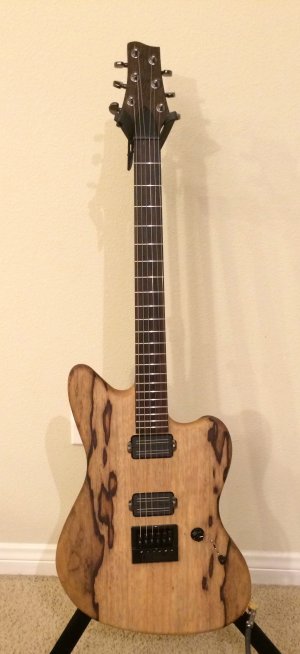

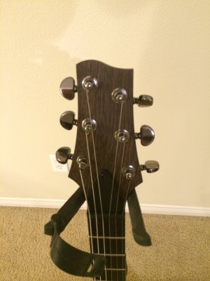

almost done, need to set the action and file the nut and reverse the tuners(oops).
I bet they have drilled for one of there own (Warmoths) trem backplates.
They, at Warmoth, really gotta get all this fixed up with these Evertune systems.  :doh:
BTW great looking build ya got going here.  :icon_thumright:
Ok here is the story on the Evertune bridges. Warmoth is no longer routing for this bridge it has become apparent that the bridge has changed and evolved over the last few years since we originally programmed them back in 2010ish. I can tell you that the sample bridges I have from Evertune during the initial programming fit the bridge route program they provided, and the initial bodies we sold with this routes never had issues reported to us on installation problems. I don't know what has changed with the bridge but with the lack of customer requests for this bridge and the issues with installing it, even Evertune has had issue with install is the rumor, we are stepping out of this and letting Evertune route bodies for their bridges. If some one really wants this bridge we can build a body and omit the bridge route which will allow the customer to send the body to Evertune, or one of there approved installers, for proper fit and installation. We are sorry for those who have run into issues with installing the bridge it is not our intent or desire to provide replacement parts that are problematic, but if is very hard to know when and what niche manufactures like Evertune change specs and designs. If you have questions or issues I would please ask that you contact sales@warmoth.com directly.

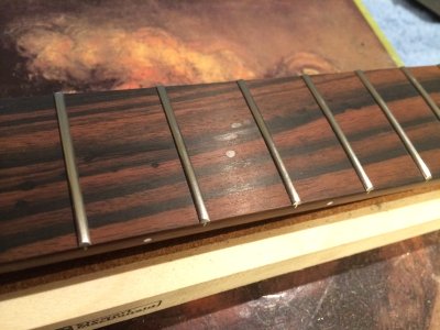

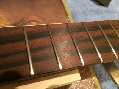

I have a question for anyone familiar with macassar ebony.  If you look at the images of the fretboard that I posted there are what appears to be some kind of glossy finish that looks like it dripped sporadically on the fretboard.  I'm guessing that is the case unless this is a common characteristic of macassar ebony?  I haven't seen anything similar to this when looking at images of macassar ebony so I assume it was accidental by Warmoth, if anyone can tell me either way it would be appreciated!
That's a shame that Warmoth isn't routing for the evertune anymore-- it's an incredible bridge and my only issue besides the poorly done paper thin section between the bridge humbucker and evertune is that the pickguard screws don't align but that was an easy fix.

What part is paper thin? It looks like where you would mount the screws is solid, and that would be the only part that matters.
Those "spots" are a natural feature of ebony (not just macassar), although it does not show in all pieces. I've seen necks with only one "spot" and others spotted like a Dalmation.
