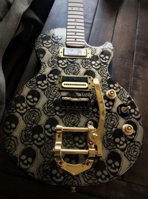

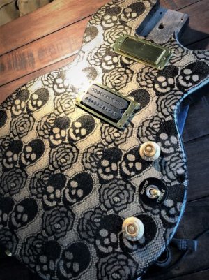

Test fit, sans bridge, may change pickups? dunno. Bridge on order going string thru Fender test neck standing by, with stew mac full pocket angled shims. If I can get it playing well and I dig it, will then order a Warmoth conversion, or 25.5" 59 shape modern with 6100's and probably a ebony board.Gold Nugget Skullet.JPG

I have re thought things again. I will post picture after reboot...........aka..."chigsby time" The pickups are a Carvin C22B humbucker (alnico 5 double thick magnet) reminds m of a Duncan JB. The neck is an Epiphone firebird pickup. That bridge is an odd no name special I found on the ZON, I decided no go. New parts on order. This may be partly ragamuffins fault.

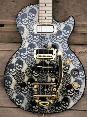

It took some doing FYI. To get the action to where I like, I ended up with a distal neck shim, I shimmed the nut slightly, and cut and shaped an approximately nickle thick plate of brass to sit underneath the bridge to raise it. I didn't think a super thick neck shim by itself was the answer. CTS pots, cloth 22 awg cloth push back wire, Sprauge orange drop cap, Wilkenson bridge, Carvin C22B bridge humbucker (like Dimarzio Super/Duncan JB cross) Duncan SM-1 mini humbucker neck. Plays great so far.
