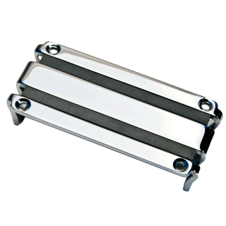

But at least it'll give me time to get lots of coats of Tru-oil on it. Also the more observant of you may have noticed it's an EMG 3.5 pickup slot, I had it changed, I was talking to Lace, and they think a Lace Bassbar has more higher frequency response, which would be better for something that is effectively a bass and guitar, than their MM which is more a traditional bass pickup. It's also available in chrome if I go that way.
Maybe, maybe not. I'm still thinking of a EMG pickup to be honest.
I thought that pup route looked "wrong.". The EMG 35 is a great shape to work with since they've made all of their 4 string pickups available in that housing.
Well, I've decided I'm going for chrome, I've ordered the chrome Lace Bassbar, from http://lacesensors.weebly.com/bass.html
I was having a bit of trouble locating any in stock, so I kinda panicked, I think they said they had some in stock. See what happens, to be honest, I don't think I'll be able to afford the other stuff before Xmas.  If I can't get any, I may have a good look at those Q-tuner pickups, they seem interesting.

Pickup turned up, the chrome looks quite nice, I'll keep slapping on the Tru-oil, as I won't be able to afford order the bridge, tuners etc till next year.
