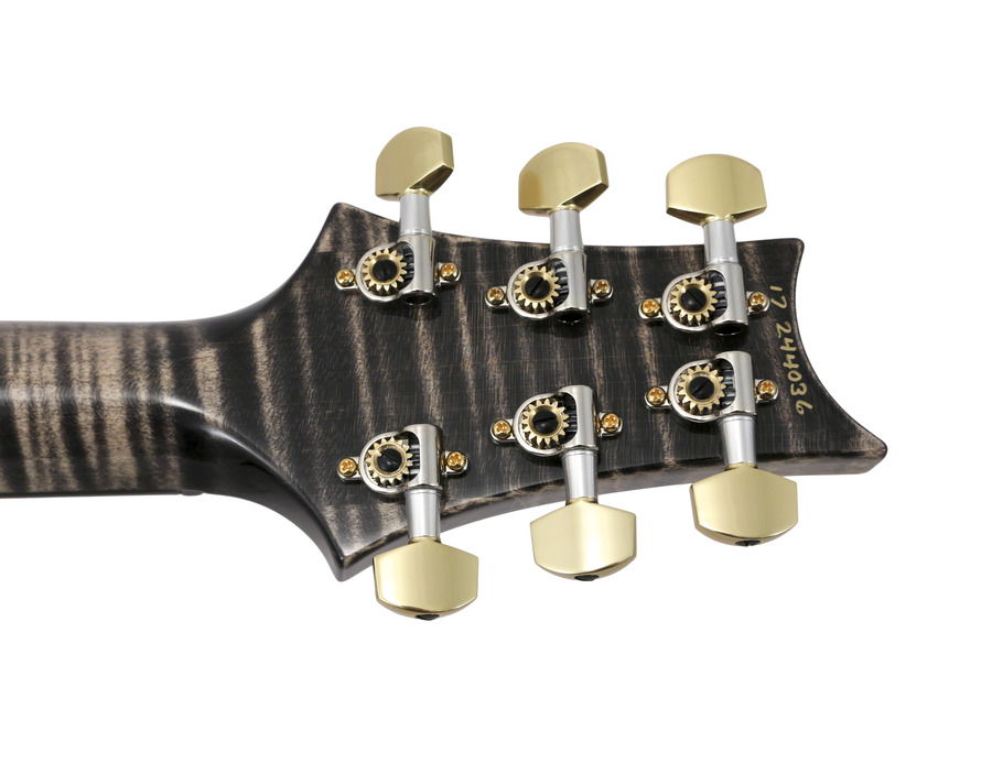

Tinted clear would be an option but not quite the look I'm after (and I don't have the spray equipment for that). I'd like to get a similar look as these, while doing the same to the body's top:
You beat me to it.  PRS and Kiesel (carvin) are doing it with success....even flamed fretboards.  I have been wanting to try it too

Something to note in that video is that even though it's Maple, they're not worried about "splotchiness" because that's not the final finish. If there's a part 2 video, you'll see them sanding most of that dye off, leaving only end grain impregnated and highlighted. Another color may be applied, perhaps in a burst pattern, then perhaps a transparent color finish and clear over that, then finish sanding and buffing after that.

I realize they are sanding the neck again to possibly add another stain (rinse and repeat for some of their color schemes) + clear coat, or color coat+clear coat.
It's just that I fail to see the challenge in the dyeing process in this particular video, assuming their necks are in fact made of hard maple. Could it be that they use big leaf/soft maple (it's suppose to still be harder than mahogany, a fine wood neck) ?
