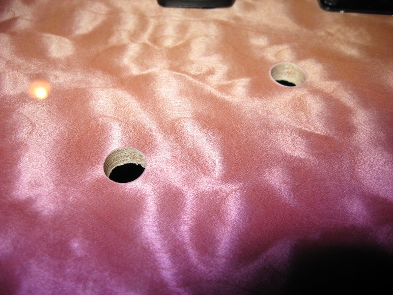

These holes were drilled with a Forstner bit...
As you can see, no tear-out and they're nice and clean.

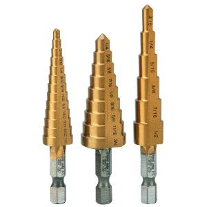

I use these type of bits, never had any issues
You use these on wood?  I use them on my aluminum and steel chassis when I'm amp buildin', but couldn't see how the steps would be of use without driving the entire bit through the body.  The steps on mine are much shorter than the depth of the wood over the cavity, for example.  I could see using these to create a bit of a countersink, however.  Come to think of it, I do have one of these in 3/8" and 1/2" max diameters, so I guess I could see how it would work.

I use those on just about everything where I need a clean hole. If you need an odd size that one of the steps would do, just get an inexpensive bit from Harbor Freight, grind off the larger steps and go ahead with it. Just don't overheat the bit when you grind on it.

In my experience, 'inexpensive' bits cost more than good ones because you end up buying multiples over time. Just buy a good definite-purpose bit to start with, and you're done with it.
Also, 'multi-purpose' bits (such as step drills) are always a compromise. They appeal to the frugal, but they're generally just gimmicky things to drain money from the inexperienced.
You're always better off to spend the money to buy the exact bit you need, and of a high-quality, and use that. Add it to your collection and call it that - a collection. This is especially pertinent to specialized bits like Forstners, brad points, router bits, etc. You often don't need every bit in a set. so why spend the big bucks there? For instance, if the bulk of your work is on guitars, you really only need 3 Forstners - 1/4", 3/8" and 1/2". Why buy a whole set? Buy just those three in carbide and you're all done forever. Buy 'em in HSS, and you'll be buying them again next year. To hell with that. It's false economy. Same with router bits. How many sizes to you really need? Spend the money to get the pertinent ones in carbide and call it a love story.
When I was working on aircraft, they were the best thing for drilling lexan or aluminum.
They rock for aluminum
They certainly do. Not for customer deliverable product, but for a quick adjustment in an R&D environment, they can be worth their weight in gold.
Used them many times to pull an ME's butt out the fire.......
