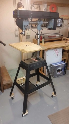

Well, I thought maybe ebay.  Found this:
Local pickup only, and it happens to be in Chicago...  It's a bit "more" than I was thinking.
Now that's a deep throat!
You're going to have to live with the fact that it sticks way out from the wall  :)
I did some reading on that particular radial arm drill press, Delta 11-090.  There were some complaints over too much flex, no crank on the table, and not low enough rpm.  I think I'm going to keep looking.
You definitely want one with a crank on the table. Mine doesn't have that and it's a PITA. If it didn't do such a good job otherwise, I'd go find a newer one.
