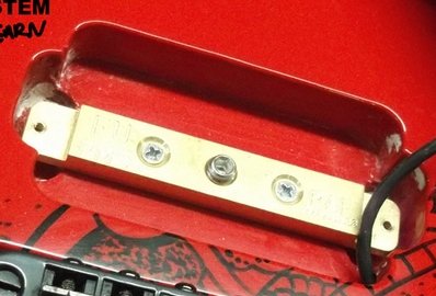

There _is_ a semi-new product called "PMS!" which stands for "Pickup Mounting Sytem".  It consists of a semi-flat, solid-brass piece that HAS the threads for your hummy machine screws.  It mounts flush to pickup route (obv. under pickup) - simple and brilliant.. It solves the problem of "machine versus wood screw", etc..  with it's design.
Can't figure out how to inline an image in order to wrap it with IMG tags as the OP has done (i.e. how's the file get to the Assets directory) so I've attached in case anyone even sees this and is interested ;-)  It _is_ a pretty cool gadget.
Since it purports a sonic benefit, via tightly-coupling with the guitar body, it is made of solid brass and thus - it's a tad expensive, imho.  I saw it at GFS, and then on FU-Tone...  Once again, the intended use seems to be for that perceived "direct-mount" benefit, but _regardless_ of that, it seems that the design would solve the OP's original use-case, which is the same as mine.  It's like a "hidden mounting ring" in a way..
The debate on how much "direct mount" affects tone is ongoing - and I don't want to participate if I'm honest...  I want what I would call "ringless-mount" purely for the aesthetics.  All I expect from my pickups is their traditional magnetic operation; oh, and height adjustment ;-)
If I had a shop I'd build some sort of small plate with threads similar to the PMS thing above.  Since I don't have that shop, and can't see paying for the brass when I'd just as soon have aluminum or plain steel, I'm likely to use OP's method.
