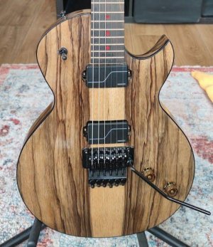

I recently ordered a Black Korina Flying V (can't wait!) and I am now starting to contemplate how to finish it. I built this LP in the past with tru oil and it looks stunning:
For my new V, I was wondering if there's a way to replicate this finish but darken the wood without losing the effect of the beautiful accents of Black Korina. Has anyone tried something like this? Any ideas?

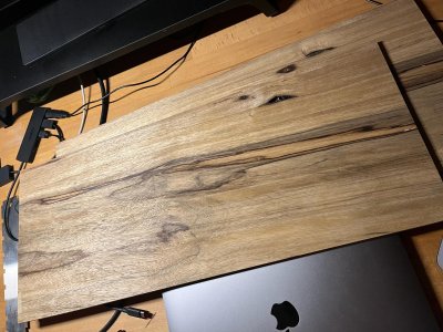

OK, I managed to get a Black Korina blank to practice (will arrive in 10 days). My idea is to do the following:
- sand down to 320 or a bit lower
- use a metal brush to open the pores
- wipe on dark brown dye/stain/glaze with a tshirt
- wipe off dye/stain/glaze with 000 steel wool (so that it the dye/stain glaze exclusively stays in the grain)
- apply numerous coats of tru oil and supplemental birchwood casey products
Anything I might be missing?

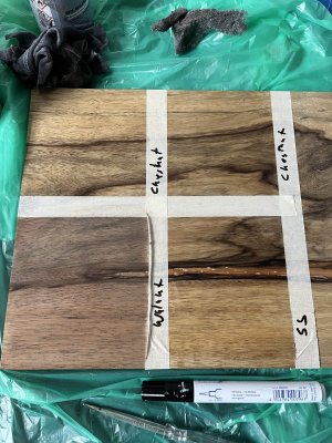

Alright, I have some first insights. What I did:
  • sand down to 240 3 times, and apply water to raise the grain in between
  • use a metal brush to open pores
  • clean with window wipe and let dry
So far, I did:
  • top left: chestnut sanding sealer (will use BC walnut stain here tonight)
  • top right: chestnut sanding sealer (will use glaze here tonight)
  • bottom left: walnut stain without any sealer (tried to wipe off with 000 steel wool with no success, as can be seen)
  • bottom right: BC filler and sealer (will use BC walnut stain here tonight)
