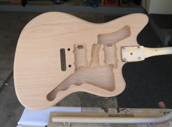

My white(ish) Jazzmaster was re-routed for humbuckers after having been originally routed for JM pickups. As you can see, the cavities are a bit deeper and they add the relief holes for the trapeze mounts...
I should mention that the body above came from Warmoth that way out of the Showcase, so you wouldn't have to have a custom body made if you wanted to go to humbuckers from P90 cavities. They'll re-cut it. It just won't look pretty until it's covered by a pickguard.
