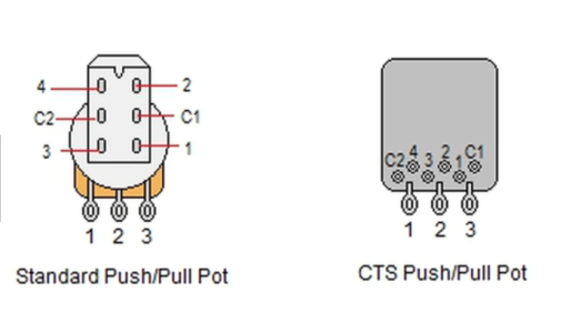

Some time ago I found this very handy comparison diagram for CTS vs Alpha or generic pots and how the tags match up.

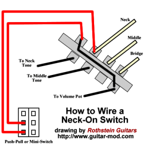

I want to wire a neck-on push pull mod, where UP turns on the neck pickup.
Will the Rothstien diagram do this for me? And is it suggesting C2 and 3 are the lugs that need connecting?
Based on the diagrams  C2 and 3 are the lugs that need connecting.
If it turns on with the pot down versus up all you would need to do is leave C2 in place and move the other wire from 2 to 4.
