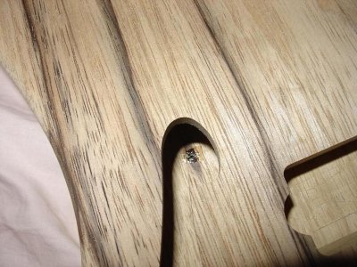

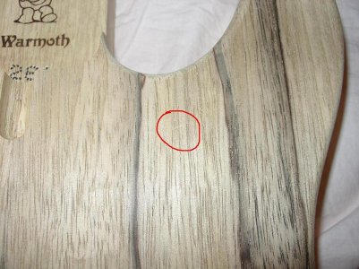

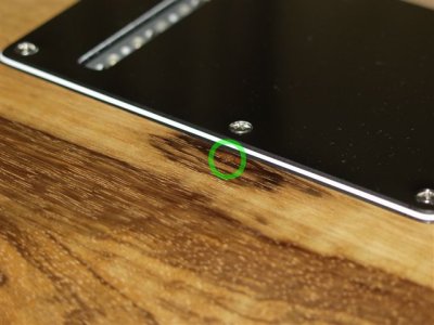

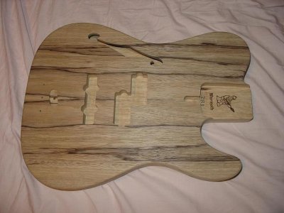

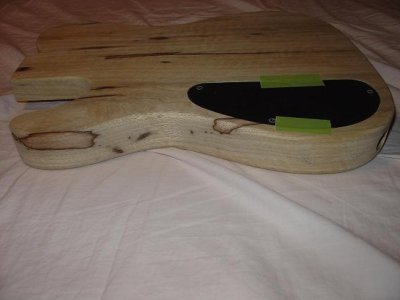

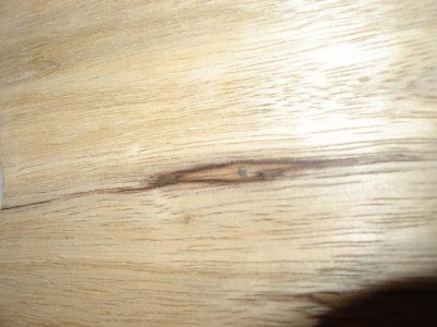

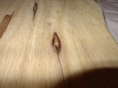

Hi Mingus,

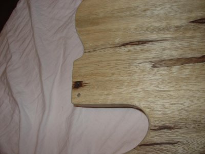

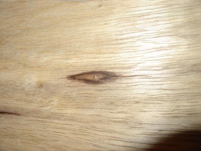

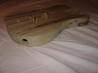

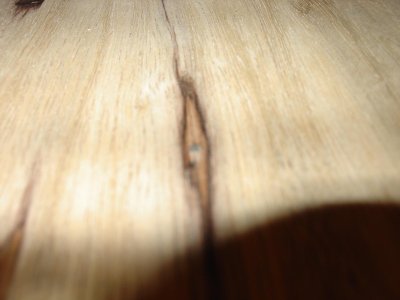

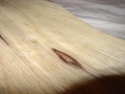

Black Korina is like that. On solid bodies we fill worm holes, benign cracks, long open pore lines and such for cosmetic reasons. In hollow construction like yours, we also use some very strong glue in those areas because of structural integrity. Then those areas get inspected because we don't want to cause warranty problems down the road.
You can expect to see a certain degree of things like this in Black Korina bodies, especially hollows.
Cool looking body. :icon_thumright:
(The patch you see will have 0 affect on the tone)
