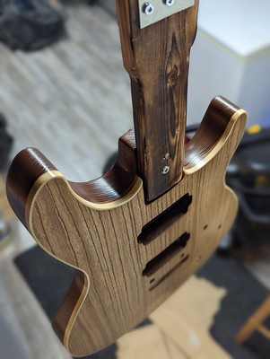

I'm awaiting my VIP body in Roasted Swap Ash with Swap Ash top. I thought of using the Shou Sugi Ban technique on the top. My main concern is the binding. Is there a way to protect the binding from the torch flame while roasting the wood grain? Any advice?

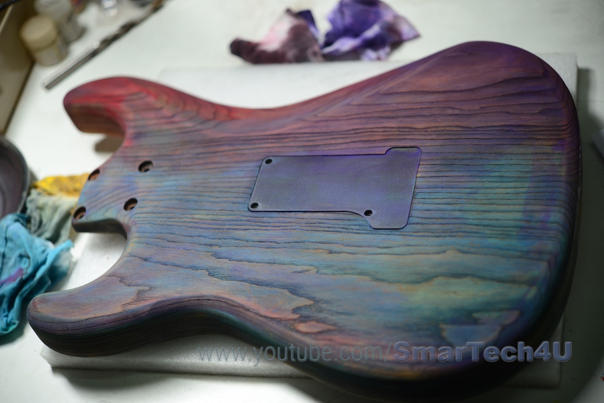

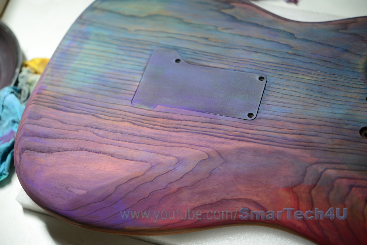

I finish edit a new video How to STAIN BURNT ASH Guitar / Shou Sugi Ban Detailed Tutorial
and multi-layers colouring Dyeing

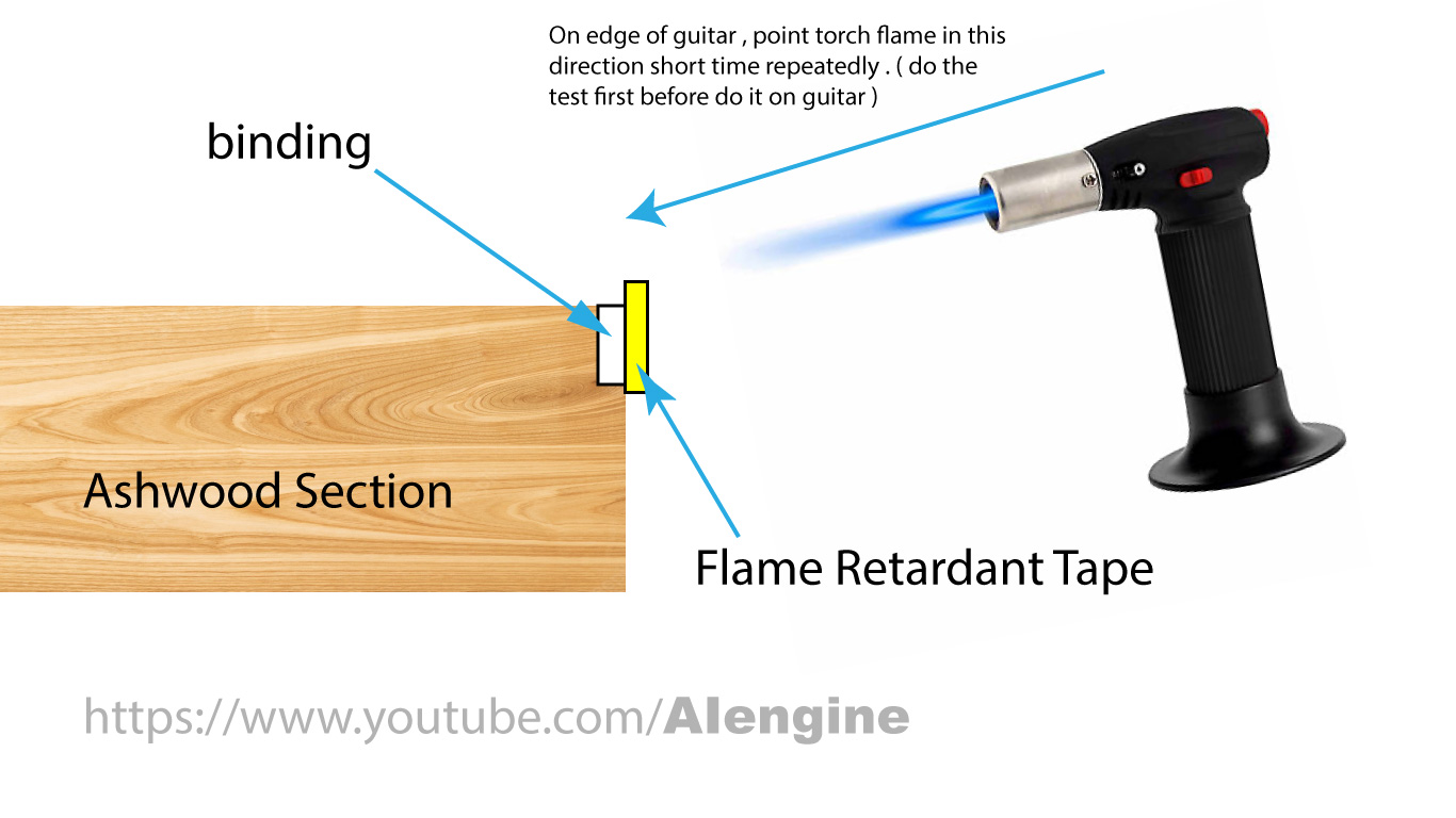

How to protect the binding from the torch flame while roasting the wood grain?
Generally I choose to avoid using some binding guitar for Shou Sugi Ban , but Warmoth only do Carved-top for Double Lam Tops , since you ask , I try investigate the possibility.
I will test use Flame Retardant Tape/ Fire Resistant Tape protect binding , something like
https://www.scapaindustrial.com/pro...capa/flame-retardant-tape-fire-resistant-tape
( do the test first before do it on guitar )
On edge of guitar , point torch flame in this direction short time repeatedly .

Maybe I'm better off putting dark dye in my Goodfilla grain filler instead. I've had good results on a scrap piece of ash using Angelus Army Tan dye in the filler putty. Putting a thin shellac coat on the raw wood before grain filling ensured that the dye in the filler didn't get anywhere but in the deeper parts of the wood. This gave good results.
Thanks! I love it. When looking closely I noticed that I should have done a 3rd pass of grain fill on the back. Some of the filler is not there anymore.
