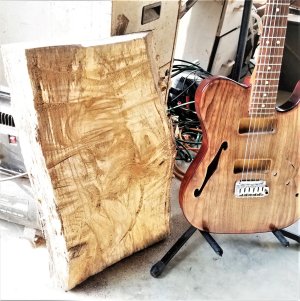

I CONCUR,  although i have some large oaks blown down from a hurricane,  and am thinking of carving something up,  i believe mine will be wall art and not playable,  takes a bit of math to get the bridge in just the right spot to make intonation possible,  thats a real positive to warmoth bodies.
ok,  i chain sawed a hunk out of a log,  hard to cut longways with a chainsaw, but here is a hunk of oak,  probably 45 lbs, 2' x 20 inch by about 4 1/2 inches thick,  big old oak, thats not chatoyance,  its chainsaw marks.
This is what I'm talking about!  Could you send me a chunk like that?
My little battery-powered chainsaw would probably just be whimpering and crying in the corner.
