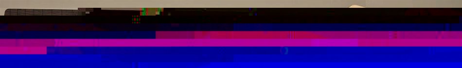

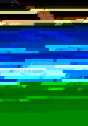

Here is the body and neck I picked up today.
Total to date: $346
Body: Stratocaster®, Right handed, Alder, Top Rout, F-Holes: None, Pickup Rout: (Strat®, Strat®, Strat®), Bridge: Vintage Strat® Flat Mount, Jack Rout: Strat® Top Jack Rout, Battery Box: None
Neck: Stratocaster®, Vintage Modern, Right Handed Handed, Maple, Wenge Fretboard, 1 11/16" Nut Width, Standard thin, 6105, Vintage Style (11/32") Tuner Ream, 22 frets, 10-16" Compound Radius, Mother Of Pearl Dots Inlay, Black Corian, No Finish, 25-1/2 in. Scale, Standard 4 Bo

After they arrive I will post more pics.

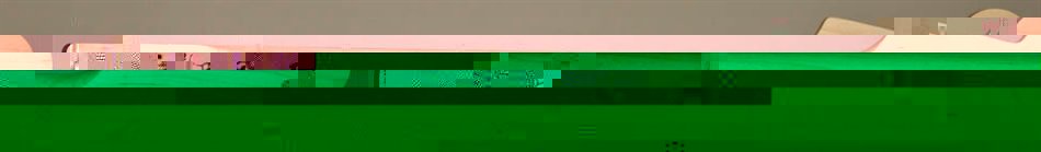

Here's the backside of the neck.
