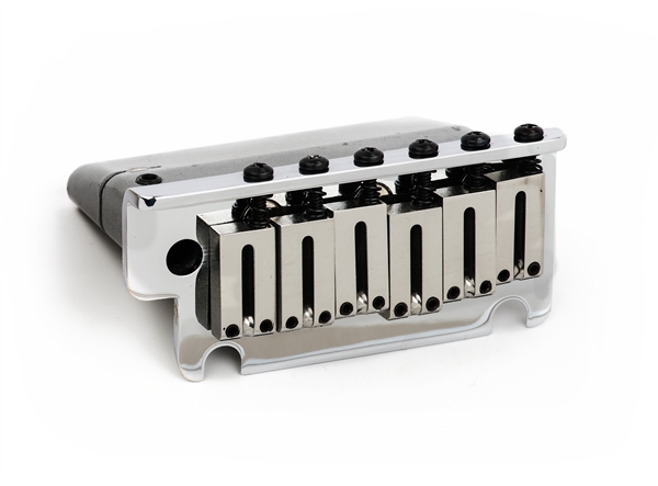

I wouldn't worry about it too much, though. Properly set up, Fender's Deluxe American Standard bridge...
...can be as stable and reliable as any modern aftermarket unit, but it's pretty tough to get a vibrato bridge from anybody that will perform worse than anything else Fender has ever supplied. So, you probably won't need to block anything you might install. If you don't anticipate using it much, then rather than block it you could just set it up with all 5 strings and pull the claw tight. That'll make it behave very much like a hardtail, but still allow you to dive it if the spirit moves you. It'll just take more effort than a properly set up unit.
