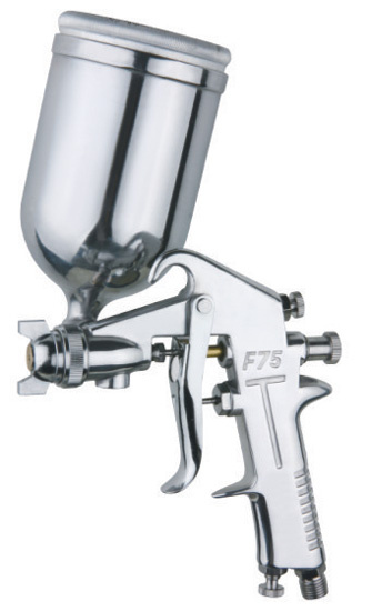

Yup - all in. But, I may be getting away with it because of my gun. It's pretty well closed up, so the acetone doesn't evaporate away and change my mix. My gun looks sorta like this...
While some guns look like this...
It's the difference between suction vs. gravity feed.
I have a gravity.  But I am only looking for a few hours, not overnight.
It's air tight.  In fact I need to open a valve on top or the liquid will not feed.
