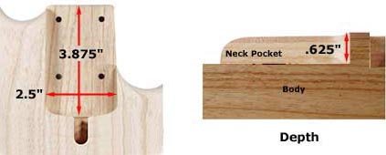

I'm 99% positive, I'm doing a little assumption here, but a Warmoth 4 string replacement neck for a jazz/P-bass is going to match fender specs for a four string bass neck pocket/your bass. (see first pic)

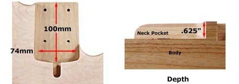

And a Five string Warmoth neck is going to match fenders specs for a five string bass neck pocket (second pic) They're obviously different.

2.5 inches across equals to 63.5 mm and 3.875 inches is 98.425mm, Yea, warmoth could have made that more clear by putting both of those neck pocket specs in the same unit of measurement  :icon_scratch: :icon_scratch:
But that's what you were looking for. The neck pocket/neck heel specs don't quite match up, but it can be modified to work (as most things can be) But as they come from Warmoth, no, it won't work as a drop in replacement without modification.
