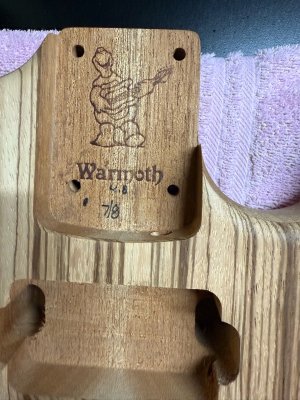

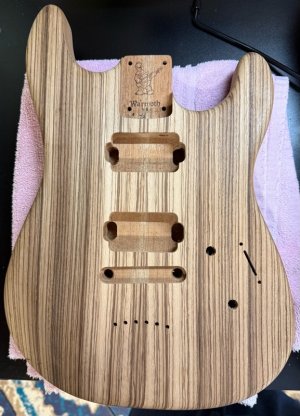

Also trying to figure out the core wood. Topp is obviously zebra. The back looks darker, maybe mahogany?
Yes, zebrano/zebra wood on mahagony would be my guess, too.
And yes, it's a 7/8, so a fitting neck would be obviously the 7/8 warhead (24.75" scale, 24 frets) or the Mustang/Jaguar (24" scale 22 frets) like I said. But those give you still a lot of options.
But very VERY important! You need the Neck Screws for Contoured Heel!!! Or otherwise you screw the neck, but not in a good way.
It's a beautiful body, have fun with it! 🤘 😊

Yes, already have the screws set aside 👍
