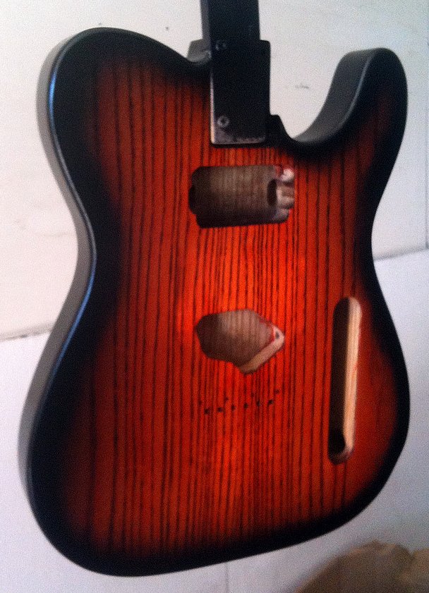

Side note - India ink that is otherwise sanded back to bare lumber remains in the grain and gives great contrast under a colored dye coat.
Example from my very first finishing project ever.  This project was coated with India ink, then I had a change of heart and sanded it back.  I then dyed with full-strength water-based General Finishes dye stain, sealed, and then filled the grain with ebony Timbermate waterbased grain filler.  Sealed with Deft rattle-can lacquer, then applied burst edge with Behlen black toner from a rattle-can, then lots more rattle-can lacquer.  I think it's a pretty nifty look.

Gorgeous!
That's a beautiful job, Ian. I love that color with the black burstover.  :icon_thumright:
Thanks, Robert.  That was the first body I ever finished, and it was beset by all manner of newbie errors and simple bad luck (such as the time the hook it was hanging from pulled loose from the ceiling the night after I applied the black burst).  I finally chucked it when two bridge screws broke off during final assembly. Swear words may have been uttered. Fortunately, it only cost me about 60 bucks cash and countless hours of "learning."
That sounds like quite a learning experience. Have you considered duplicating that beautiful finsh on one now that you know what you're doing and (presumably) have hooks that won't pull out of the ceiling?
Indeed.  Next time I get my hands on an ash body I may well go for it.  I still have 7/8 of a can of orange General Finishes water-based dye stain in my chemical cabinet.
