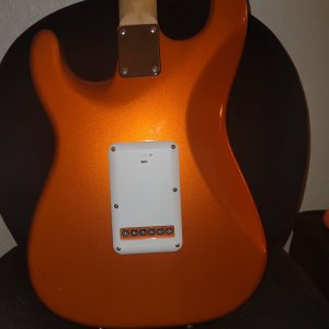

You put the trem back cover on a hard tail with the backplate slot around the ferrules. Okay, I suppose you had to drill for the connection wires etc. Perhaps post some photos.
It would look less correct to my mind on a hard tail but it is another possible option.
Waraxe
Senior member
144
You are correct. 1 hole to be drilled for the wire, and obviously the 6 for the plate mounting screws.
To me, not seeing a back plate on a strat hardtail is still weird after 13 years or so. Well, maybe 10 of those. I did get kinda used to it, then went crazy with the whole active circuit (clapton), backplate, ease of use concept.
To the untrained eye and non players, a hardtail looks like any other strat. I don't think many would pick up on the painted area and ferrules or the hardtail until they actually pick it up.
I have to say, it works really well and lasts a really long time between charges....... unless your jack is touching the foil shielding tape and discharging it in 2 weeks time. Lol
Yeah, it took me a while to finally figure that one out. 🤌🤌🤌

Thanks for posting the photo, it seems to work out well.
