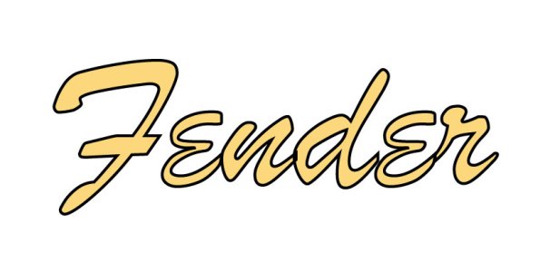

Planning on doing my own water-slide decal with a "fender" font whenever my Warmoth neck shows up. Still need to buy the water-slide paper, but I 'm handy with Illustrator and graphic design. Although I haven't been able to find the real "fender" font (other than some posts about it being removed at the request of Fender), I found something similar. Attached is an example I did. If you strike out elsewhere, drop me a note and maybe we can work something out.

Thanks, I'll keep that in mind.
Thanks for all the other replies as well. 'Much appreciated.
