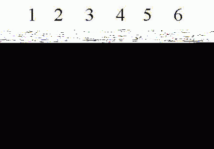

The attached diagram works as follows;
1. Neck only
2. Neck/Bridge in parallel
3. Bridge only
4. Neck/Bridge in series
5. Neck/Bridge in parallel (out of phase)
6. Neck/Bridge in series (out of phase)
(Note that the first three selections are the options on a standard 3-position switch, so they are grouped here for convenience of use.)
1, Neck +, 2. Neck - , 3. Bridge +. 4. Bridge -.

ibob,
Yea, that's the way they have it diagrammed, but I just swapped the wiring configuration for position 1 and 3 to get the set-up I listed above.
Eric "GuitarEC"
