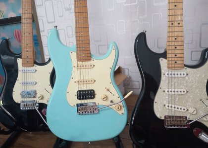

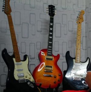

Finally got projects back and done that reflect one strat with an alder body and one with a poplar. Taking into account different necks and similar style yet different pickups I am not finding anything lacking in either. By no means any scientific comparison but I had been curious myself what I would think. I am pleased with both.
