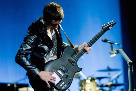

Just saw that Matt Bellamy of Muse has Fuzz Factory and a Kaoss Pad MIDI controller built in to his guitar.
