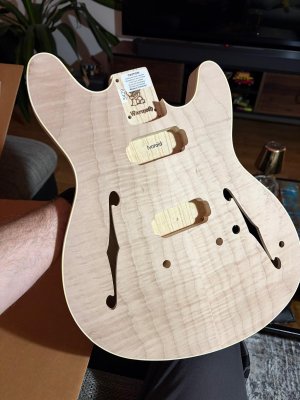

Body:
  • Swamp Ash Mooncaster with Flame Maple Top, Ivoroid binding and 2 F-Holes
  • TV Jones with Ears
  • Gotoh Wraparound bridge
  • Green/Orange Burst finish with water-based stains and Tru-Oil
Neck:
  • Roasted Flame Maple Meadowhawk with Ebony Macassar fretboard and Ivoroid binding
  • Wolfgang neck profile (yup, experimental haha), 10-16 compound, SS6115 frets (as always..)
Wiring/Pickups:
  • TV Jones Powertron in bridge, TV Jones Classic in neck
  • One vol (treble bleed), no tone, 3-way toggle
  • Treble Bleed

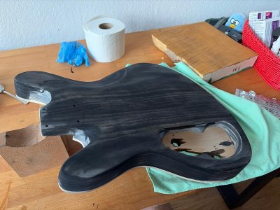

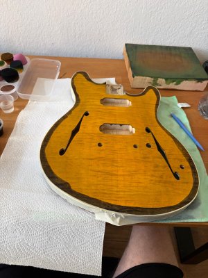

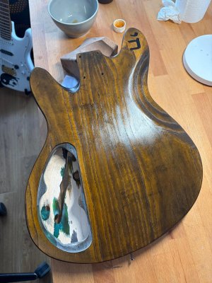

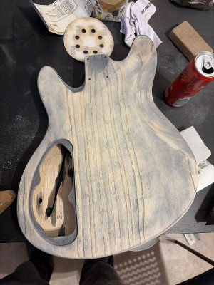

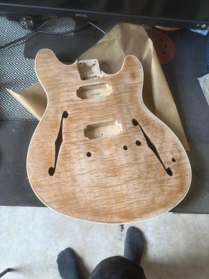

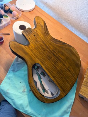

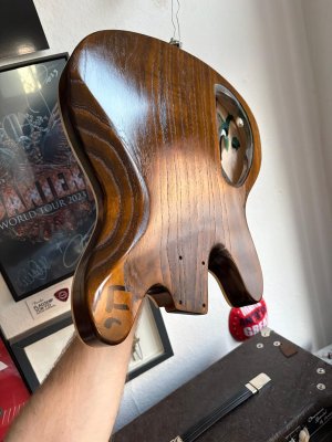

The finishing plan:
  • end result: green/orange burst on front, dark brown (barn look) on sides and back
  • step 1: brown stain on front, black stain on back to pop grain -> sand back
  • step 2: burst on front, brown stain on back
  • step 3: tru oil
  • step 4: polish & wax
Oh and of course... all the sandings, tears and frustrations in between.
This was my blueprint for the end result:
I went on to paint the front orange and the back brown
On the back there were a lot of imperfections. While I hate relic, I do like to see that a guitar was actually experimented with. So I decided to leave it just like that.

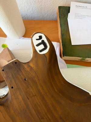

Before I moved forward, I used India ink to tattoo the guitar with something gimmicky (I tend to do this with pretty much every guitar I build). So I added the Hebrew letters for "alive" to the upper horn:

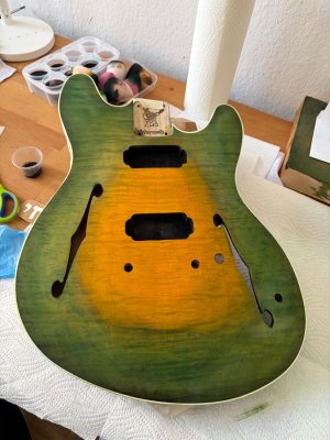

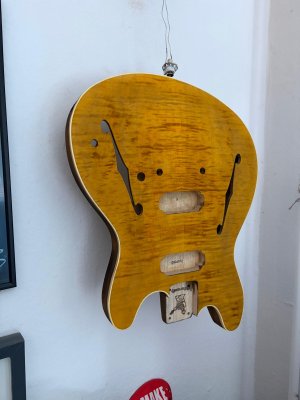

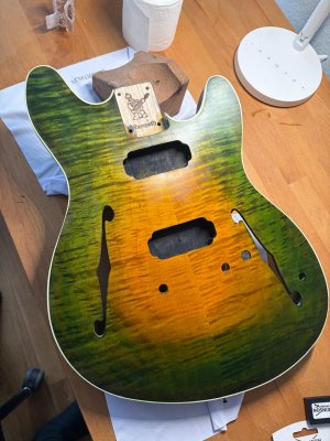

On to the front... My first burst finish. It was CRAZY hard but I kind of went into flow mode and then it just happened. I am very happy with the end result.
Starting from the outside (black) with the orange ground coat. In the back you can see me test wood :-)

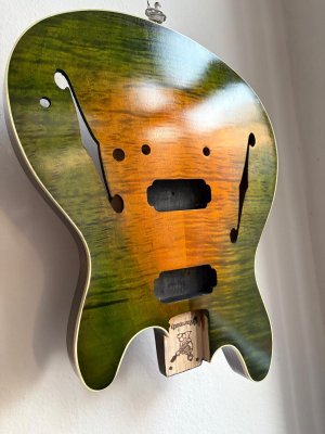

And here's how it turned out:

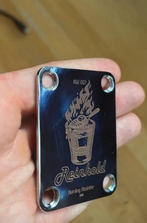

Now it will be drying for 3 weeks. So there won't be a lot of updates. But meanwhile, here's the amazing neck plate - as always ordered from the amazing TLC Guitar Goods (amazing shop in Holland, for all Europeans - I am NOT affiliated!)

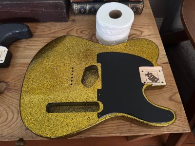

Nice job Alex! Looks great. Also glad to know you keep toilet paper near in case of emergency!
You have really inspired me Alex, does this pickguard look View attachment 68331ok?
LOL 😂 here's the deal though. I ran out of kitchen towels and then used toilet paper (which I simply never switched back to kitchen towels). Purpose was to wipe off any excess stain, instantly clean accidents on my desk and wipe off excess tru oil from the container where I put it before applying.
Long story short: kitchen towels / paper towels are actually crucial for a finish like this
Oh................I understand, your saying it serves a dual purpose.

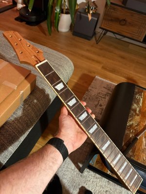

Before I went to do a full setup, I noticed I had to do A LOT of fretwork. This was my first bound neck and it seems Warmoth is not as meticulous with the fret ends as with non-bound necks. Take a look at how aggressive the fret ends stuck out:
After the whole 9 yards (leveling, crowning, beveling, polishing), the neck was smooth as silk (in fact, I absolutely love the Wolfgang profile):

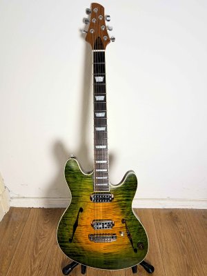

So here's the end product. I am very proud of this build. It was my first time doing a burst finish and my first time working with a bound body and neck. Strangely, I was not as excited about this build as I was about other builds. But since the guitar has been finished, I have been playing it non stop. I absolutely fell in love with it.
HERE IS THE LINK to the Guitars & Bass Gallery.
