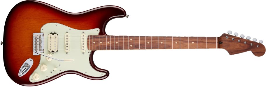

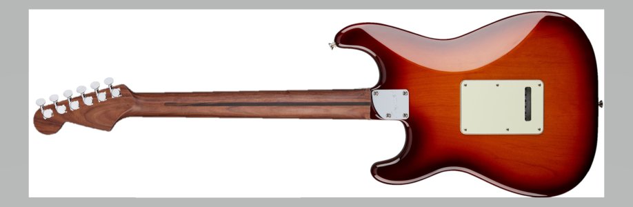

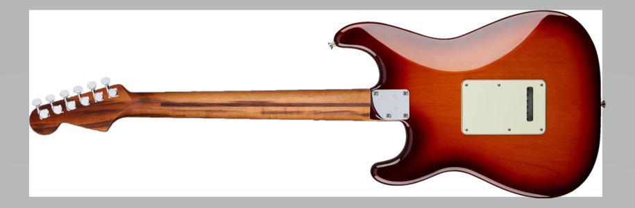

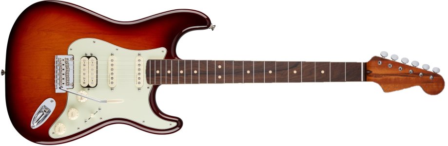

With the help of the awful photo manipulation app that comes with Windows, some mockups have me thinking either Goncalo or Pau Ferro will look best with tobacco burst.
Hmmmm.
