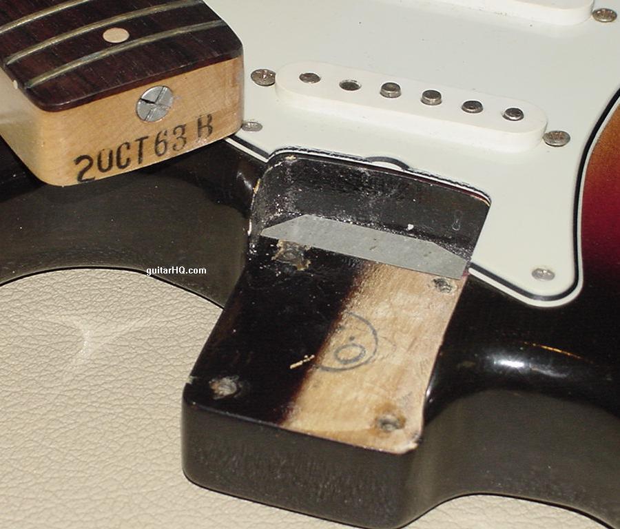

I think the 50/50 side dots are from back in the day when Fender used thinner veneered fretboards, and only half of the side dots would fit on the rosewood.
A '63 Strat w/ veneer board

I think the 50/50 side dots are from back in the day when Fender used thinner veneered fretboards, and only half of the side dots would fit on the rosewood...and maybe, nowadays, the only reason they still do 'em that way (even if the board is thick enough not to justify it) is because they used to do 'em that way.
I'll bet you're right.
