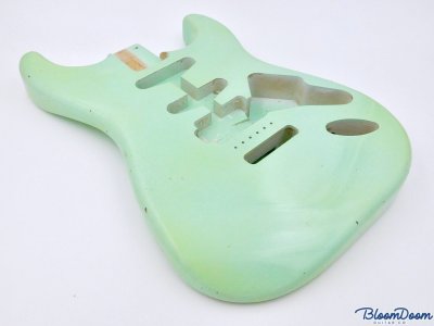

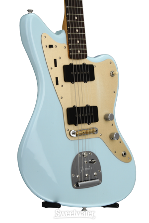

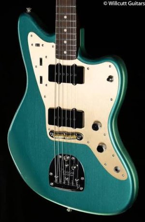

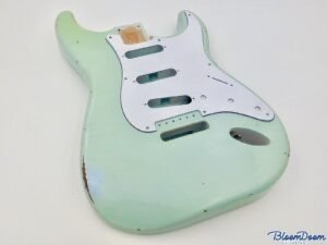

Ive ordered a gold anodized pickguard, so choice one is locked in. Finishes are killing me, here’s what I’m considering:
Sherwood Green:
Sonic Blue:

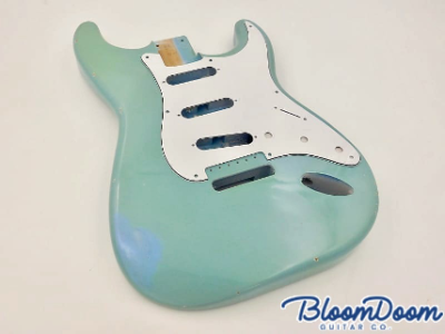

Yellowed Variants of Sonic Blue / Daphne Blue / Surf Green:

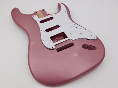

Burgundy Mist:

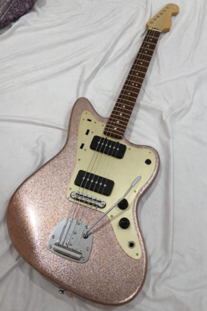

Champagne Flake:

Those are all awesome, my first choice is champagne flake. For vintage style I really like Sherwood Green and Burgundy Mist. Are you doing matching headstock? (Do it.. do it…)
If you don’t have a flake/sparkle guitar: this is the one to do it on.
Do blend some of your choices together, how about the Ws Turquoise Flake? Not how sure that will work with your Pickguard.
A Red Flake would.
Yeah, big Gretsch vibes from the champagne. Matching headstock… maybe. Then we have to talk binding and blocks and that’s a little too much visual drama
A Red Flake would.
I have two other sparkles - a Chartreuse sparkle Tele and a ruby sparkle thinline.
W might make the neck but their body won’t line up with the pg I ordered. Turquoise flake would be killer though. Green flake - like Bonhams Ludwigs - would be pretty eye catching too.
